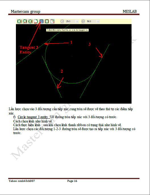

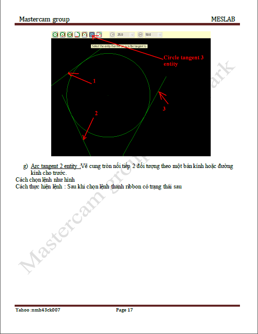

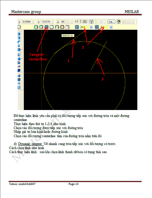

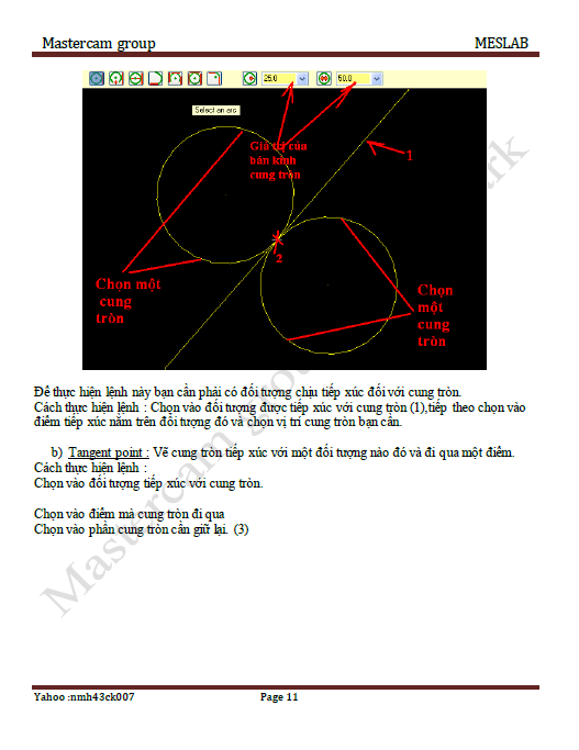

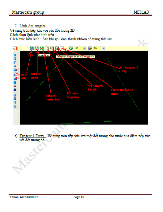

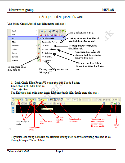

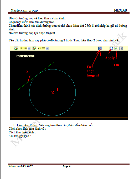

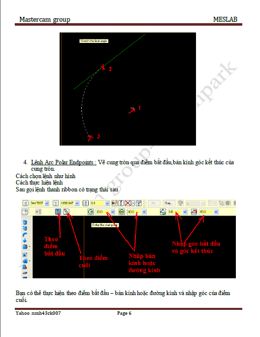

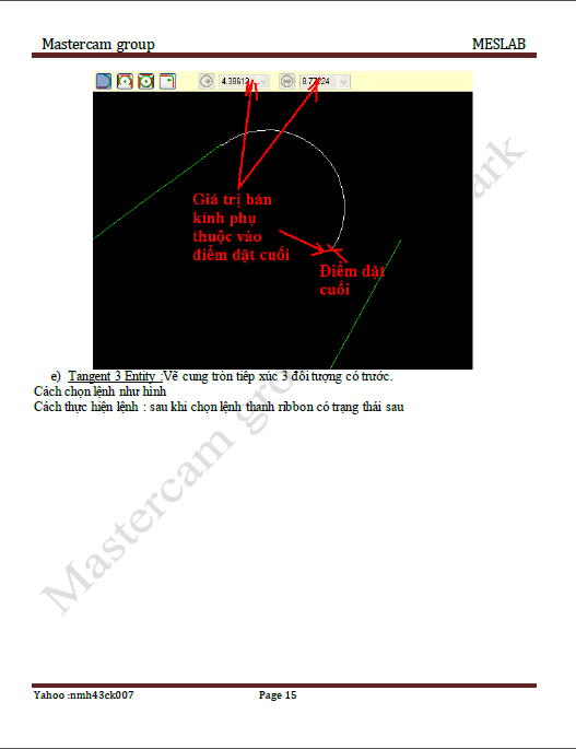

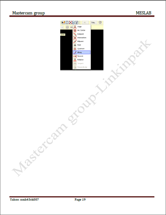

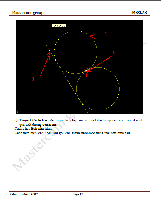

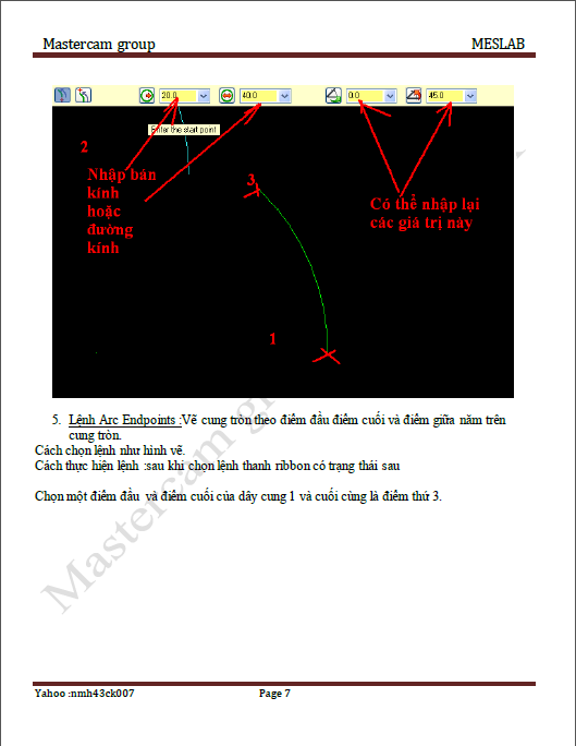

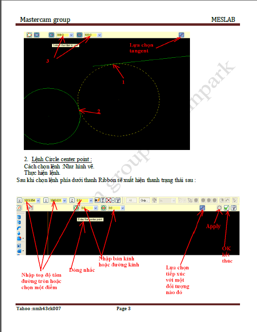

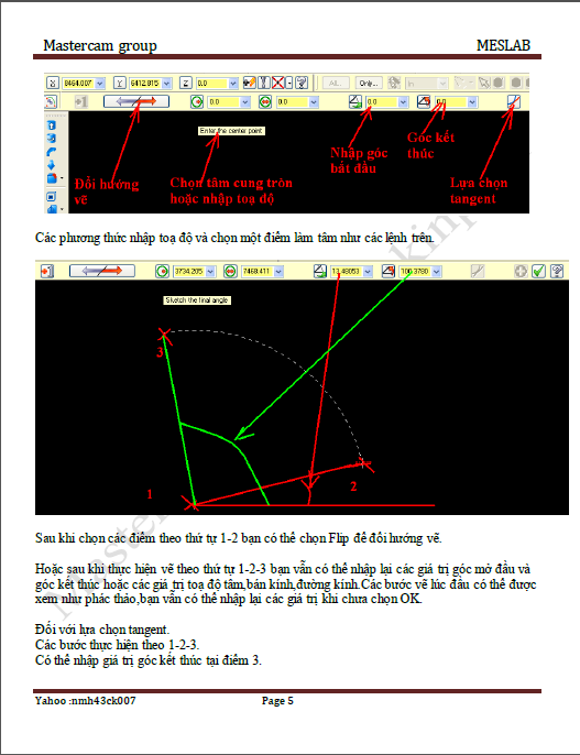

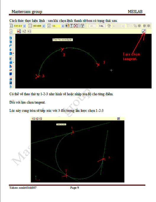

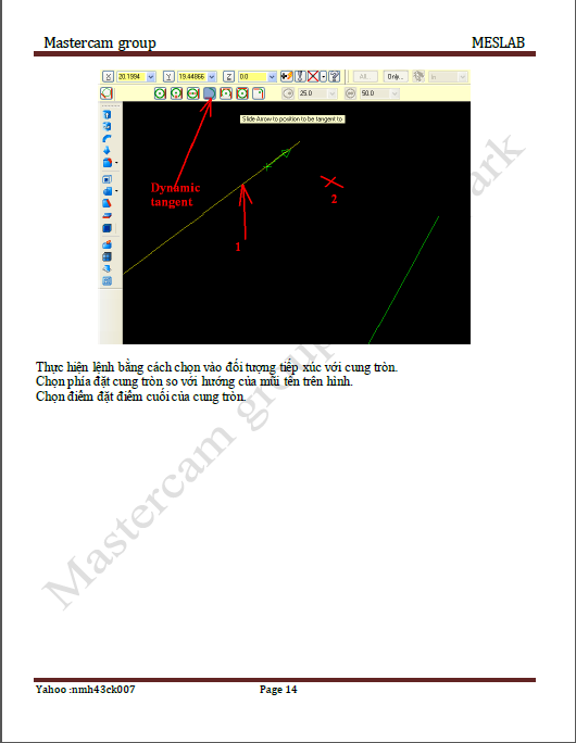

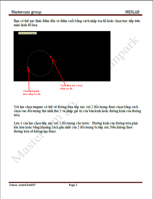

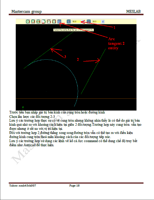

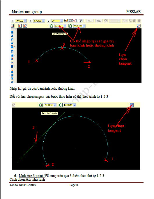

Kết quả sau 2 tuần như đã lên kế hoạch mình và Thái đã hoàn thành các phần đã nhận và trao đổi nội dung cuối cùng chọn ngày hôm nay bắt đầu đăng bài.Và sau đây là phần của mình.
![](http://i831.photobucket.com/albums/zz240/nmh43ck07/Arc/1-7-201111-44-53PM.png?t=1294420018)
![](http://i831.photobucket.com/albums/zz240/nmh43ck07/Arc/1-7-201111-45-54PM.png?t=1294420871)
![](http://i831.photobucket.com/albums/zz240/nmh43ck07/Arc/1-7-201111-46-29PM.png?t=1294420874)
![](http://i831.photobucket.com/albums/zz240/nmh43ck07/Arc/1-7-201111-47-09PM.png?t=1294420912)
![](http://i831.photobucket.com/albums/zz240/nmh43ck07/Arc/1-7-201111-47-37PM.png?t=1294420926)
![](http://i831.photobucket.com/albums/zz240/nmh43ck07/Arc/1-7-201111-48-06PM.png?t=1294420979)
![](http://i831.photobucket.com/albums/zz240/nmh43ck07/Arc/1-7-201111-48-43PM.png?t=1294420981)
![](http://i831.photobucket.com/albums/zz240/nmh43ck07/Arc/1-7-201111-49-19PM.png?t=1294420984)
![](http://i831.photobucket.com/albums/zz240/nmh43ck07/Arc/1-7-201111-50-02PM.png?t=1294421497)
![](http://i831.photobucket.com/albums/zz240/nmh43ck07/Arc/1-7-201111-50-39PM.png?t=1294421054)
![](http://i831.photobucket.com/albums/zz240/nmh43ck07/Arc/1-7-201111-52-05PM.png?t=1294421059)
![](http://i831.photobucket.com/albums/zz240/nmh43ck07/Arc/1-7-201111-52-32PM.png?t=1294421061)
![](http://i831.photobucket.com/albums/zz240/nmh43ck07/Arc/1-7-201111-53-04PM.png?t=1294421417)
![](http://s831.photobucket.com/albums/zz240/nmh43ck07/Arc/?action=view¤t=1-7-201111-53-36PM.png)
![](http://i831.photobucket.com/albums/zz240/nmh43ck07/Arc/1-7-201111-53-36PM.png?t=1294421119)
![](http://i831.photobucket.com/albums/zz240/nmh43ck07/Arc/1-7-201111-54-09PM.png?t=1294421124)
![](http://i831.photobucket.com/albums/zz240/nmh43ck07/Arc/1-7-201111-54-42PM.png?t=1294421205)
![](http://i831.photobucket.com/albums/zz240/nmh43ck07/Arc/1-7-201111-55-11PM.png?t=1294421327)
![](http://i831.photobucket.com/albums/zz240/nmh43ck07/Arc/1-7-201111-55-52PM.png?t=1294421207)
![](http://i831.photobucket.com/albums/zz240/nmh43ck07/Arc/1-7-201111-56-20PM.png?t=1294421209)
